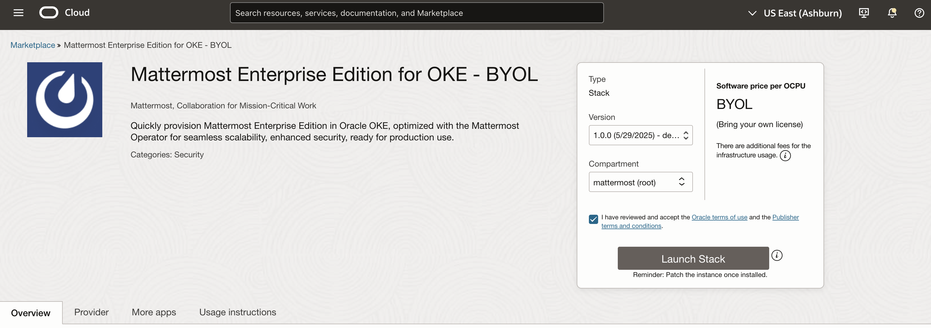

Step 1: Start from Oracle Cloud Marketplace
Go to the Mattermost listing and select Launch Stack.
Oracle Cloud Marketplace listing for Mattermost

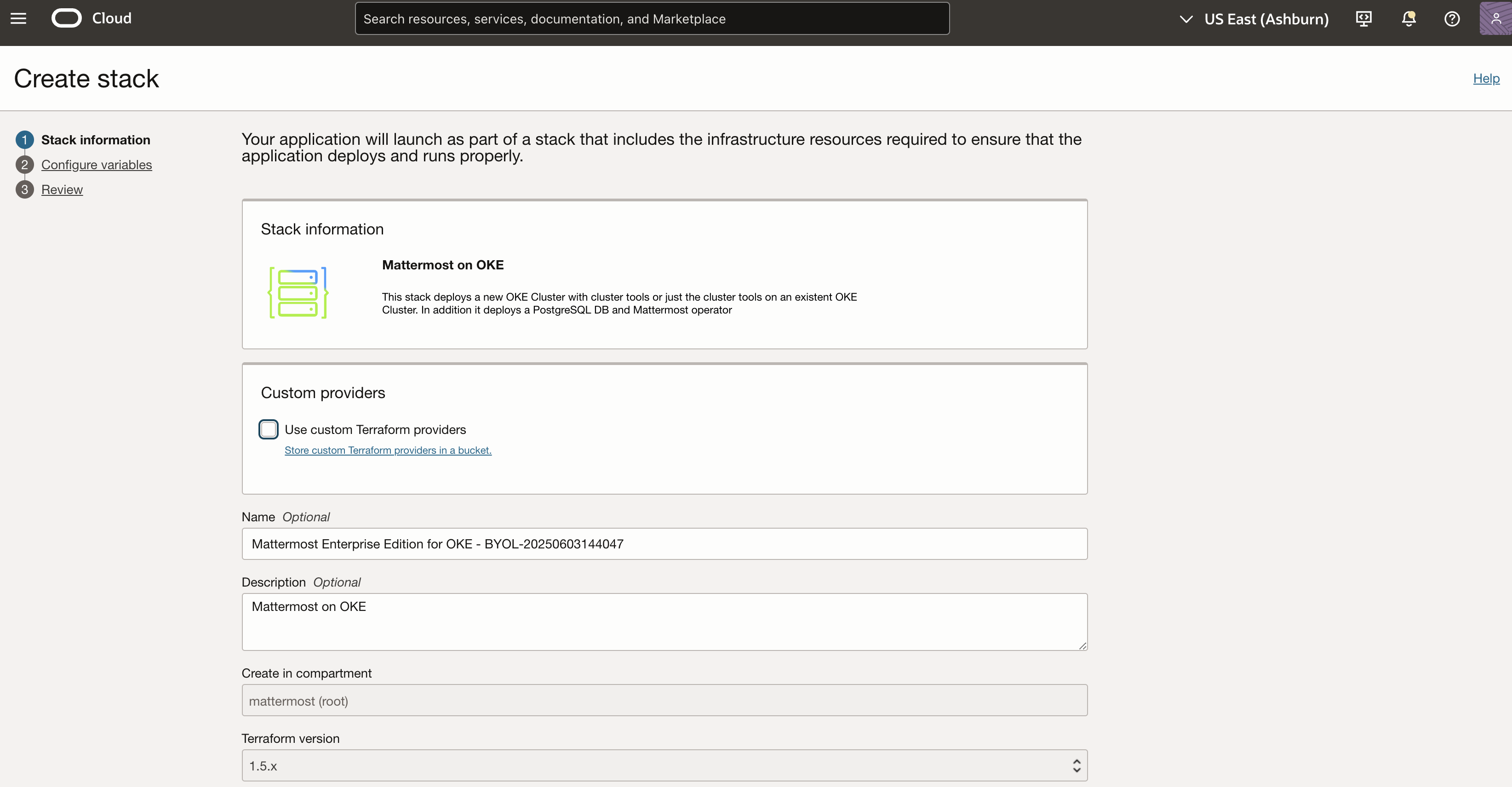

Step 2: Stack Information
On the Create stack page, review the information, and then set the name, compartment, and Terraform version.
Stack information page

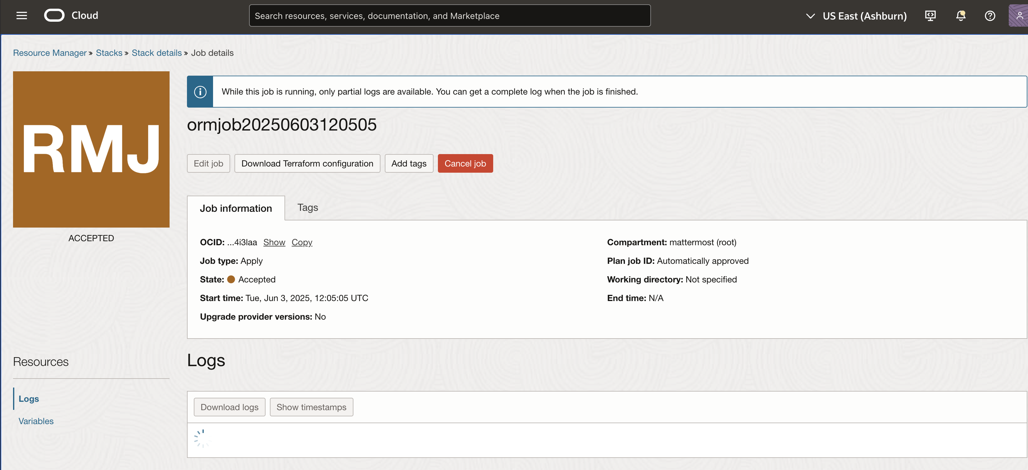

Step 4: Review and Apply
Check all your settings and select Create to start the deployment. Monitor the Resource Manager job and logs.
Resource Manager job monitor
